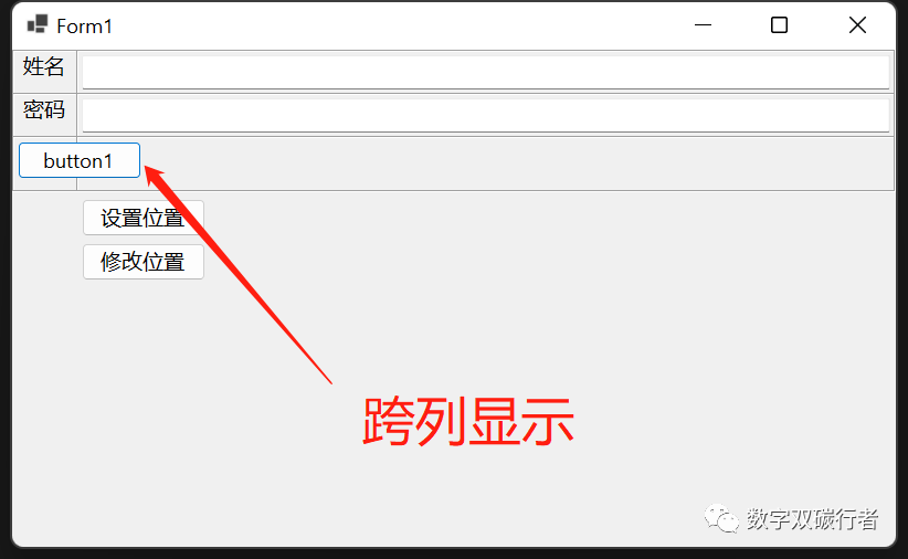

将按钮控件添加到Table的1列2行

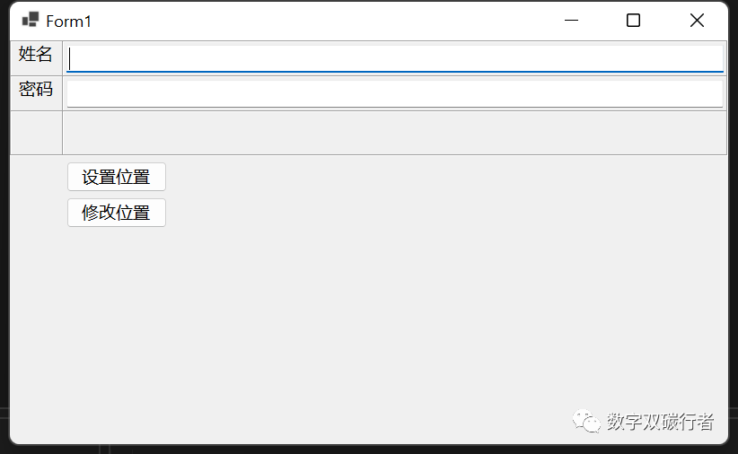

修改Table中控件的位置
private void btnSetPostion_Click(object sender, EventArgs e){    tableLayoutPanel1.Controls.Add(btnSetPostion, 1, 2);}private void btnModifyUser_Click(object sender, EventArgs e){    tableLayoutPanel1.SetCellPosition(txtUser, new TableLayoutPanelCellPosition()    {        Column = 1,        Row = 2,    });}
设置跨列或行显示ColumnSpan
